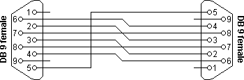

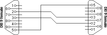

Hello Begginer, You have RS232/MPI ?
Well this article is a RS232 PC/PPI multimaster cable. You have to choose in WinCC flexible, transfer settings -> RS232 It is not possible to connect OP73 Micro to S7-300 CPU. Only S7-200. See faq: http://support.automation.siemens.com/WW/view/en/21120013 Best regards, Wizard |
